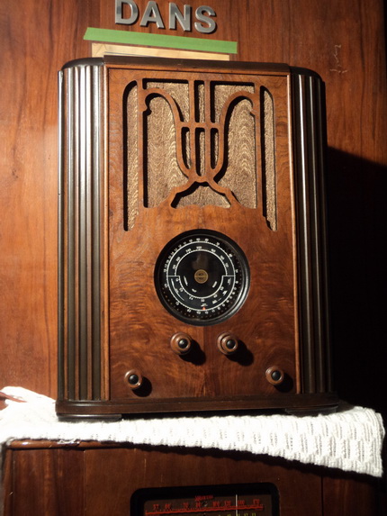

I bought this at an estates sale yesterday.
 It is a Northern Electric   tombstone, model C800.. It is the largest tombstone I own standing at  22 inches tall.
 It has the original grill cloth and knobs[except one] which I have.
I might have to replace the transformer, but I really like the dial as it had no dial, just  a rotating light  that shines through a disk.
 Quite a complicated system and I am glad I don't have to repair it.
I know it will look good after I do the cabinet and it is a keeper.

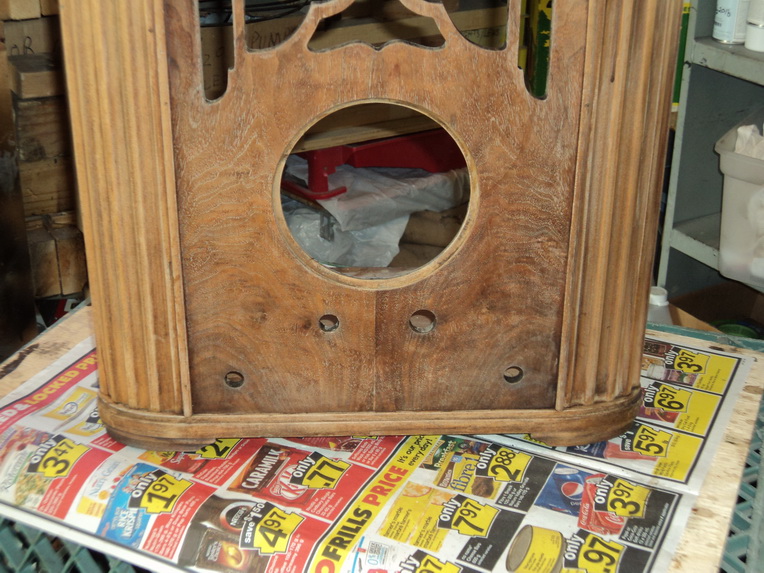

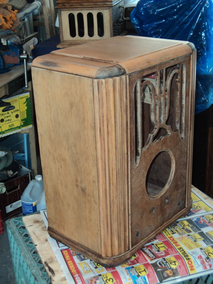

I now have it stripped ,and it is a lot lighter than before, so I will have to use some  light walnut or Vandyke brown toner  when I get to that stage.
Dan in Calgary

Today I installed the chassis in the refinished cabinet.
It took a bit of doing to get the pillars the way I wanted but it came out OK.
   This radio is one nice Canadian radio, I will probably keep it.
I installed a phono jack in the rear with a switch , to play MP3  or  radio
The radio sounds very good  with push pull 6f6 tubes.
Dan in Calgary
