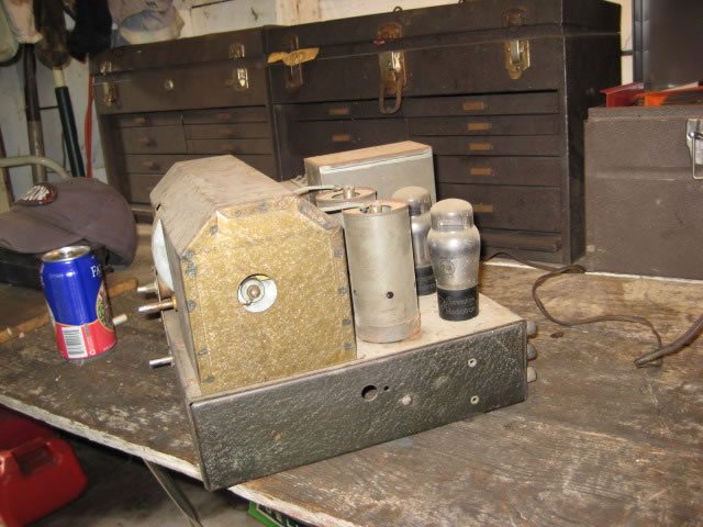

So I was in town yesterday ( Alameda, CA) and at random walked into the Alameda Museum gift shop. Sitting in the floor was this massive table top radio. Its rather generic looking, but extremely well-built. Its a Kemper radio with no markings except for the Kemper stamped dial surround and the dial itself. They wanted $40 for it which sounded reasonable.I'm guessing early 30's?
Its incredibly heavy and once I got it home and opened the back, saw that there are numerous large transformers and a speaker-also with a huge transformer built into its chassis.
The radio came on but no sound came out. The problem wound up being the with mechanics of the tuner mechanism, which uses a worm driven gear to turn the tuning plates. After a quick bit of oiling and tightening of the set screws of the gears, everything came loose.
The best part is that it actually works great! The radio has a very homemade look to it. When I bought it I thought that maybe it was a homebrew. But doing some research, it was made by a small outfit in Los Angeles- Kemper radio Corp. The company started out in a garage and sold factory-direct. So This was probably not a huge production set. The cabinet definitely looks hand-built. The chassis and other components are all very high quality.

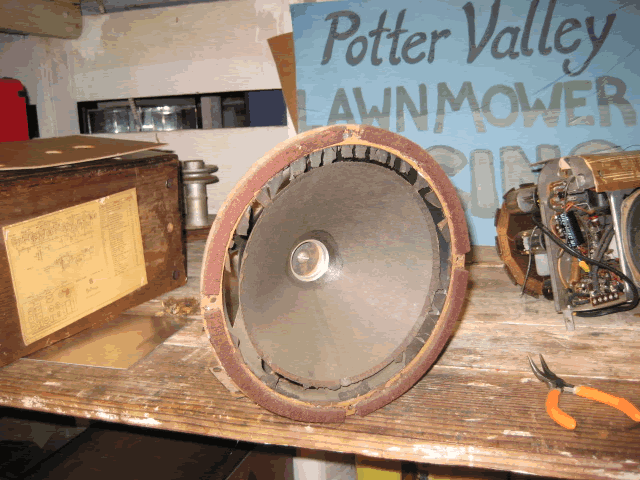

The speaker surround was shot. I'm making a new surround as we speak using a little trick I learned using cloth and wood glue( will show pics later)

On two things I don't agree. One, that speaker needs major help on outside edge of cone. You need cone centered right, or, it will badly rub.

I spent the better part of the weekend cleaning and repairing the set. As far as I can see, there seems to only be two capacitors. One at .15 and 1500 volts and another that's un-marked. The electronics supply is closed, so that will have to wait.
I spent hours with a tooth brush and cleaner on the chassis. It actually came pretty clean. The biggest issue was the speaker. I cut out a pattern in cloth and glued it in as a new surround. It doesn't look fantastic, but I've done this in the past and it works well. Nobody will see the front of the speaker anyway.
One of the tubes in the set is a blue color. Never seen that before. The brand is "Arctucus".
After cleaning the cabinet with Howard's then putting two applications of floor wax over that, it cleaned up pretty well. Nice patina.
Anyhow, it works great as-is. But I will replace the capacitors whenever I get around to getting to the shop.
