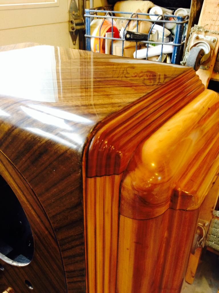

OK, some photos of the cabinet work.
This is after regluing the cabinet, making everything tight. The gaps and and cracks were filled with wood filler. Grain lines were painted back in over the damaged areas with artist brushes and oil paints. Over this went a couple of coats of thinned shellac. This sealed the cabinet and protected the painted grain lines.
Then grain filler. Wait a long time because even the oil based stuff shrinks a little. A few applications of that. Then some clear coats. A tiny bit of toner on the white wood – maybe not enough – but it was as close to radiola guy as I could get.
http://www.radiolaguy.com/Showcase/Console/Arvin927.htm
A second to last coat wet sanded with 600 and 1000. Then a final coat followed by 600, 1000, 1500, pumice, rottenstone, jewelers rouge and finally cornstarch – tip from Eddie Brimer, not sure it did anything but make a mess. Then wax. Going to let it rest a week because I won’t have any time until next weekend. Then Bob’s beautiful chassis goes back in. With fresh chassis grommets from radiola guy.
Some pictures:
Check the area where the waterfall crack was. It is as perfect as I can make it.

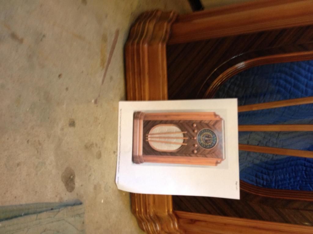

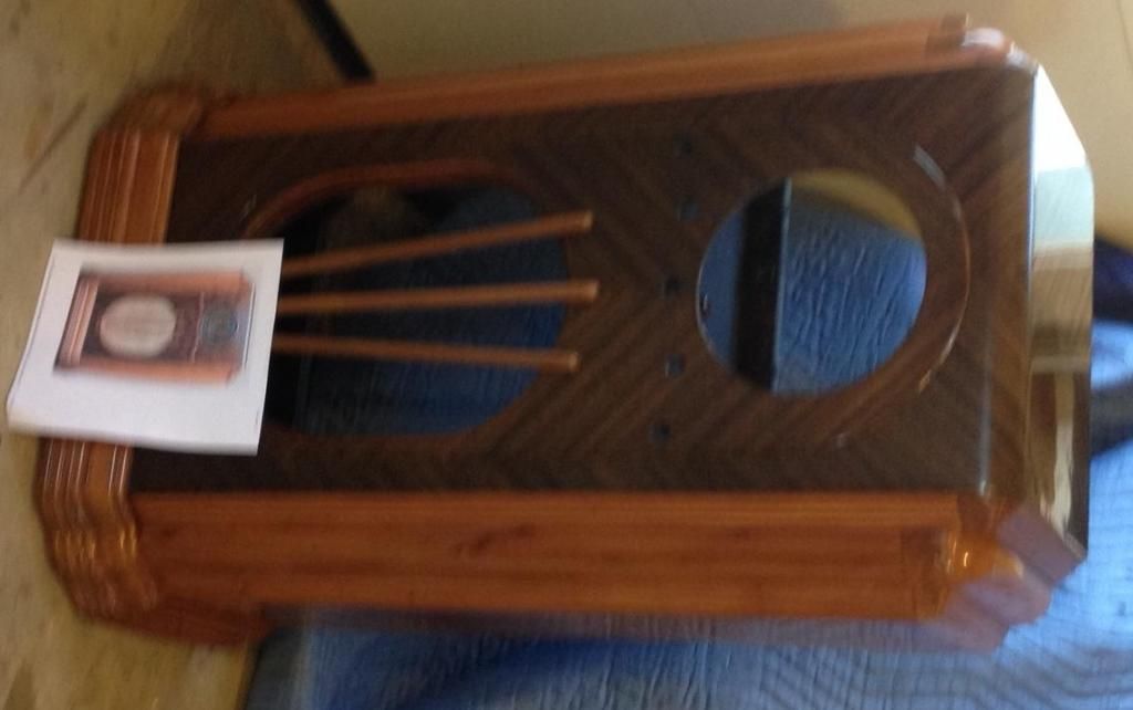

Here is a couple of pictures of my attempt vs. Radiola guy. I might have paid too much attention to the printouts and forgotten to look at the internet pictures because the white woods are probably not toned enough. After 400 hours, it is what it is.

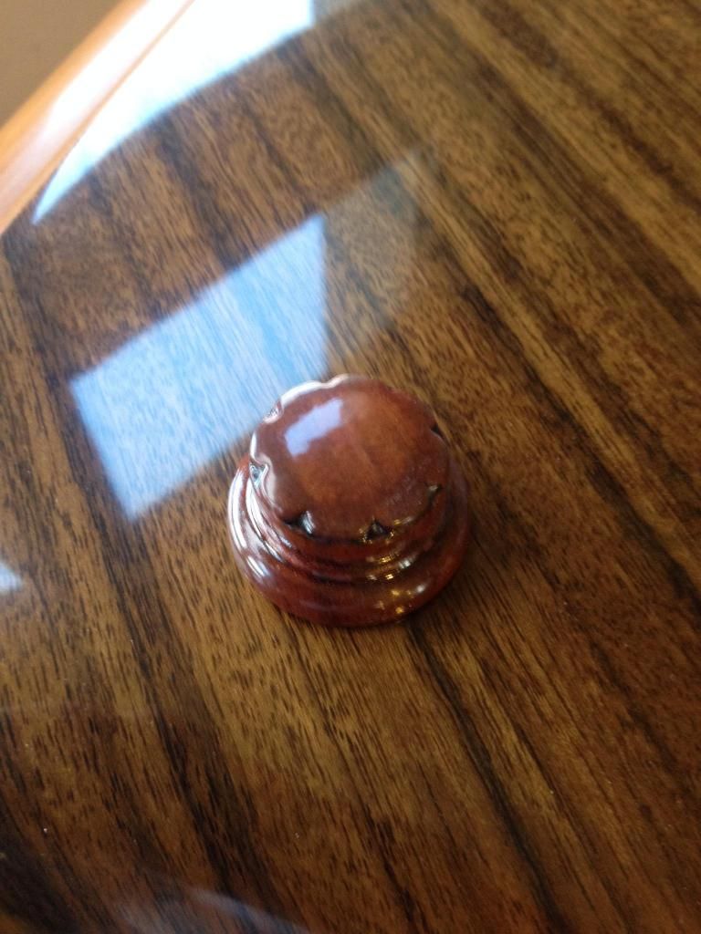

Sorry for the sideways pictures but you get the idea. Final picture, the knobs or knob in this case. I saw a restoration of a Queen that was over done in my opinion, but the knobs had a red tint that I liked. But too red. So I shot the knobs with some redwood pigment in the lacquer and then layered some medium brown over them. In person they have a lot of depth and beautiful hints of red that does not photograph.

In the thirties, the gum wood or poplar parts of the cabinet were sprayed with non grain raising stains probably alcohol based. The few guys I talked to about this that are the top of their craft - Kenny Richmond and Eddie Brimer being a couple, do not use stains but rely on using toning lacquer to add color.
If I ever use a stain, it will be a dye based non grain raising stain that is disolved in alcohol and applied with a gun. Transtint stains look acceptable. Certainly a thirties radio never had stain applied with a rag or a brush and nothing water based was used. Interesting article here.
http://www.rockler.com/how-to/wood-stain-in-a-nutshell
I was severely cautioned about overdoing the toning lacquer mist coats to the point that I under did them. I agree with you that the sides are too light. I think the walnut veneer is already dark enough - possibly even too dark - but I am very happy how the veneer ended up.
I do not like a popular style of radio refinishing these days where the solid wood is toned almost black. Not at all. Nor do I want to shoot for perfectly uniform color across the radio. I like some contrast between the veneer side wood pieces and the veneer. Also between the grill bars and the veneer.
Since we both agree that the sides are a little too light, I have to decide whether I am going to mask off the veneer, again. And apply some more toner mist coats and rub out the finish again, something I spent about 80 hours doing already.
Or do I enjoy the radio for a while, Tough call. Thanks for your advice and nice words.
