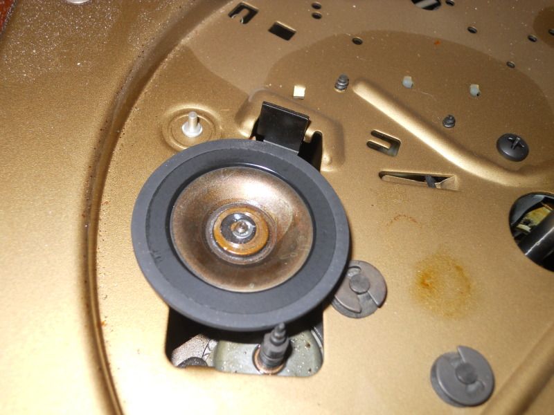

Ok, I just installed a new idler wheel in this early 60's Ambassador console unit. However, the idler wheel isn't gripping the platter with enough tension to get it through the automatic cycle. I'm thinking that there might have been a spring between the silver post sticking up and possibly the flat piece that is also sticking up next to it. What do you guys think?

Ambassador Console Unit Issues Empty Re: Ambassador Console Unit Issues
Post by fixinmyphono Thu Sep 29, 2011 5:30 pm
I think your right!
Post by repairtech Thu Sep 29, 2011 8:21 pm
It's a VM changer.
The tension spring should be underneath - one end fastened to the idler arm and other end to the chassis hook at the top of your photo - I can see the spring loop there.

Post by Bill Cahill Thu Sep 29, 2011 11:09 pm
Actually, I believe the spring might go below on this one. Gary Stark of VM Enthusiasts can help, and, I'm positive, find you the spring from his vast inventory from what used to be the VM corporation.

Post by PhonoBrit Fri Sep 30, 2011 5:14 pm
The spring underneath is still attached.
Post by PhonoBrit Mon Oct 24, 2011 5:40 pm
Ok, to get more "bite" from the idler wheel as it wasn't quite hitting the center of the motor spindle. I removed the paper fiber washer from underneath the ilder wheel and this lowered the idler wheel and made it purchase more of the spindle as it was now centrally located on the spindle wheel. The platter now has enough torque to get it through the automatic cycle.
