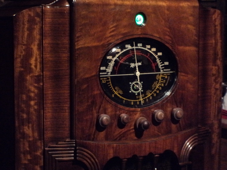

Marconi  model 85 Empty marconi model 85 All Done
Post by Dan Walker on Fri Feb 03, 2017 7:34 pm
Today I finished this radio except the knobs. I will have to strip and lacquer them when it gets warmer.
 Everything went together as planned.
The eye tube I used  is one of those from Japan ?   They are on Ebay. it works very well and is very bright.
Now I have to find a place for the radio.
Here are the photos
Dan in Calgary
Marconi  model 85 All_do10

Marconi  model 85 Empty Re: Marconi model 85
Post by Tony V on Fri Feb 03, 2017 8:19 pm
Nice job Dan! I wish one of these would come available near me as i love the looks of the Marconi's and other canadian model's for that matter. Most american consoles are bland in comparison. Thanks for sharing this restoration with us.
