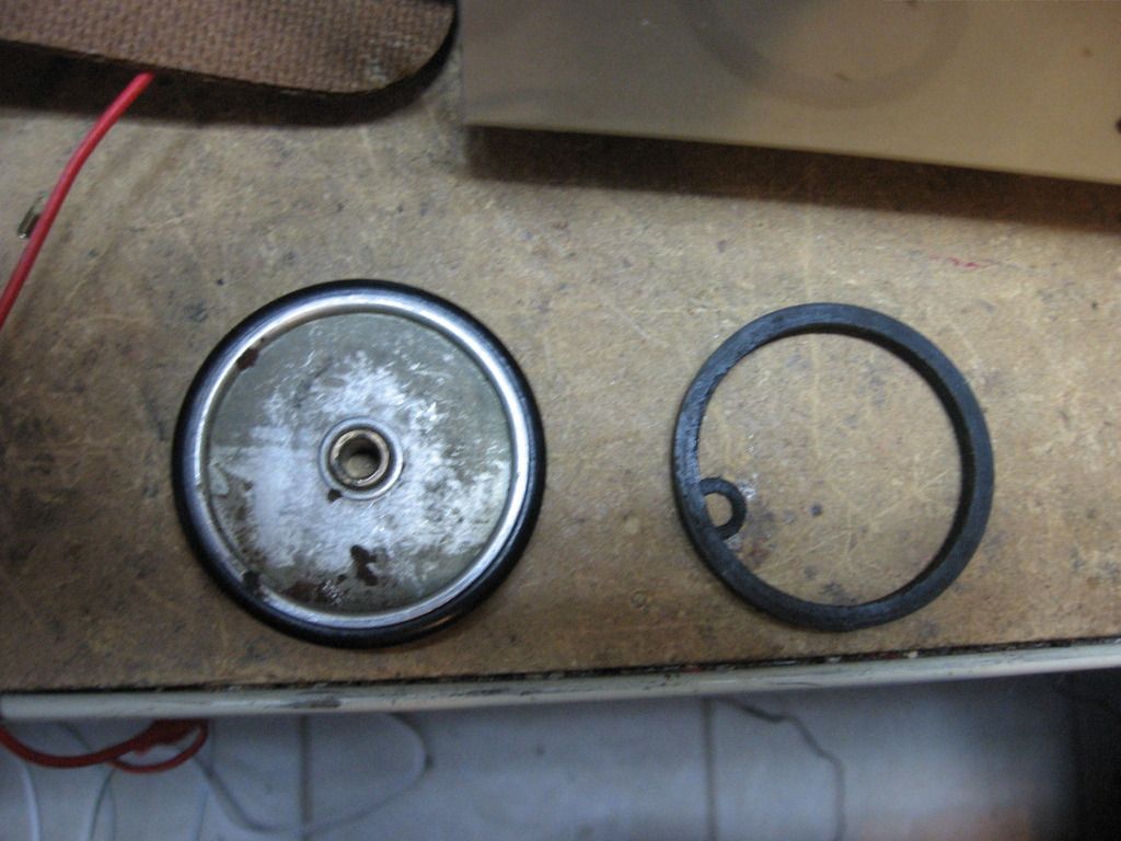

I have a truetone 1845 from the late 40s I am fixing for a friend. So far I have it almost done except for the record player. I got lucky and had a smaller NIB ceramic cartridge than it originally had. It seems to put out a great sound so I probably will go with this. The last issue I see with it is the speed of the turntable. It seems to be going around 40 to 55 rpm instead of 78. I took it apart and the idler was dry and not gripping. I expiremented some and I found out a O Ring will fit it perfect and right thickness. The old rubber tire came right off like the way old VCR tires did. I can put it on and it runs and seems to grip. The shaft of the motor seems to have a wire wrapped around it for some reason. It is pushed down the shaft and does not make direct contact to the idler wheel.

new tire

My only suggestion would be to take the motor apart, soak the bearings with lacquer thinner overnight, then re-oil with turbine oil or synthetic motor oil (or whatever) and see if that helps. Are there any rubber mounts on the motor assembly? Are the mounts still pliable and soft? It looks to me like you have the rest pretty much covered. Magnavox/Collaro changers have a spring on the motor shaft. It's job is to space the fan on the motor and the drive shaft for the platter drive. You have to make sure the spring is on correctly or the fan will fall into the motor and make a racket, or the drive shaft for the platter will not be positioned correctly, affecting the speed. For what that is worth.....

Yahoo! I got it!! I went through this morning and took the motor apart completely. I didn't have the thinner you mentioned but I did have some clipper blade cleaner used for hair clippers. I dipped the plates that house the motor bearings in there. I had to go to town for a few hours and when I got back I put it all back together. I made some new rubber motor mounts out of some grommets I had. I was able to put one in the hole on the motor frame and then cut a different size grommet in half. By doing this it put it at the exact height. I then put on idler with the O ring on it and assembled it all back. After this it seems to be correct speed and will eject.
