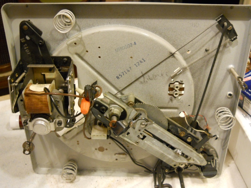

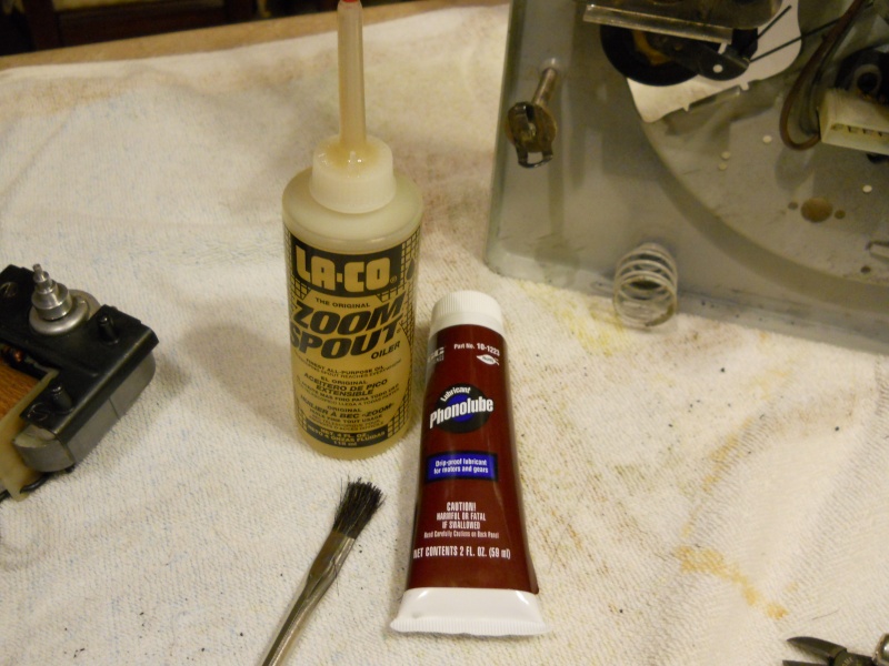

Here are some pictures as promised.  I appreciate the interest in and help with this project.  I have learned a lot and perhaps someone else will be helped with their project sometime by this thread.  Not in any particular order of importance.

The "nector of the gods" for record changers.  Zoom spout turbine oil and Phonolube.  I got the turbine oil at Grainger's and the Phonlube at VM Enthusiasts.

Here we are, with the motor in, everything lubed and ready to see if it works.  It didn't!  Read comments previously.  I was bummed.
Here is the top of the changer.  I guess I need to put the platter on to see if it works.  It still didn't.  I was still bummed.
The final product.  Cleaned, lubed, ready to go.  Almost.  See above.
