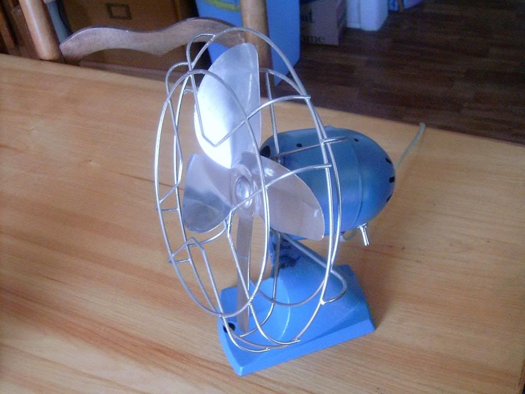

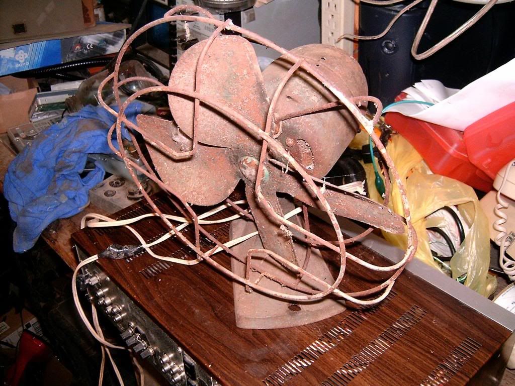

On small items I use Electrolytic rust removal. Its a easy process to use. It doesn't remove any of the good metal  and doesn't warp items. The item may have a black coating but that can be washed off easy. There is a lot on the web about it. Only down side I have seen is that if the piece is electroplated like chrome that may come off. Other than that I prefer it as it is the easiest I have found and it can be done while I am doing something else.
I had a old fan I wanted to restore. I took it apart and cleaned the fan ,fan cover and case using this method. I didn't want to warp or bend the fan blades or fan cover. Here is a before
And the after picture.
After it was clean I washed off the black from the cleaning. I then dried it and primered all the parts. I painted the blade and cover with spray can chrome paint and the fan motor an frame with blue spray can I had. I use it on my workbench.
