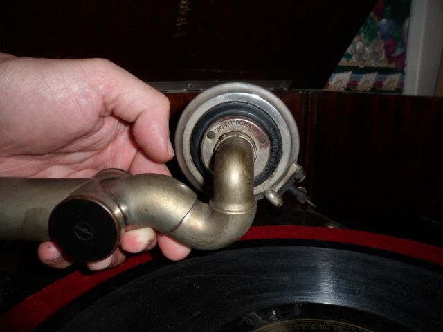

This is supposed to be an HMV. The reproducer just lays on the record. Is something missing? I know there's lots of issues with it. You can see the elbow on the horn is not quite right. Is this a fake? http://photobucket.com/HMVPhonograph

What do you mean by "just lays on the record"?
It is hard to tell by the pictures what you are describing.
Most reporducers (sound box) sit with the needle full weight on the record.

I don't have a needle in it and it just lays heavy where the record goes. It won't turn with the reproducer on it.

you should be able to rotate the reproducer up off the playing area so that you can change needles etc,
the end portion there is a swivel section

I can change needles but it just sits heavily. The record won't turn, it's so heavy on it.

I noticed that the speaker horn is not soldered in the neck in one large area. I will see on the web if I can whats what.

You should also be able to swing the arm off to the right side of the platter.

Yes, I can move it. It just seems like it should be higher or have some tension or something.

Post by simplex1040 on Wed Aug 29, 2012 10:26 pm
While this is not an HVM it shows reproducer sitting on a record with needle
close up
reproducer swiveled up
My tone arm swings to the back of the platter out of the way to chnage records. It appears that your reproducer should swivel farther up and stay in a rotated up postion ( what I can kind of tell from the picture.

It will have the full weight of the reproducer on the record.
Now if you are testing the motor you need to move it out of the way and off if you set the reproducer down on the platter with no needle and record it will stop.

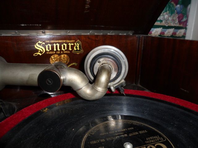

To answer your other question, yes its a fake or reproduction. It doesnt look like any parts are missing. It appears that you have a one spring motor which may be too weak to turn the turntable once the reproducer is placed on the record.

I got it to work. But the elbow for the horn isn't connected. So sad and frustrated it's a fake. Sad
I was afraid of that. Some parts seem real. I got it on ebay and compared the pics to some that I dknew were real. Looked questionable but good enough that in desperation to find one-seemed ok. $350 Ba Bye.
I at least want to get it to work properly. It plays now, just the horn I guess. So sad.

look here there is a pin bearing missing on the bottom of the reproducer tube at the bend.
So get the Horn soldered and Lube the movable joints on the reproducer and tube.
See if there is that pivot pin or get or make one.

It is a fake. It was made in another country. I doubt ebay will do anything about it, but, you could trythem, and, also Pay Pal.
I've been collecting antique phonographs, and, restoring them most of my life. These parts are bits, and, pieces from portable wind up machines, and, some plumbing parts, as well.
Case looks like it has been painted black to look old.
The horn elbow isn't made correctly, either.
They make them out of pieces of plumbing. The horns are very thin, and, easily bent up.
I'm sure it has got a small one spring motor in it.
The arm is made all wrong, and, looks like tracking is also wrong, and, will never be right.
