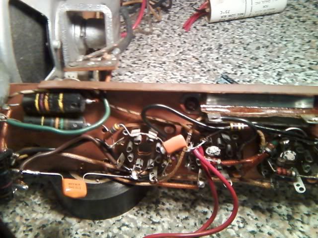

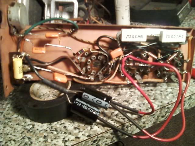

Post by fixinmyphono on Sun Oct 02, 2011 3:59 pm
before and after Everything sets in a metal box (cover is off) and the large capacitors sit in a clip to keep them from moving around.Eight capacitors and eight resistors in all.
